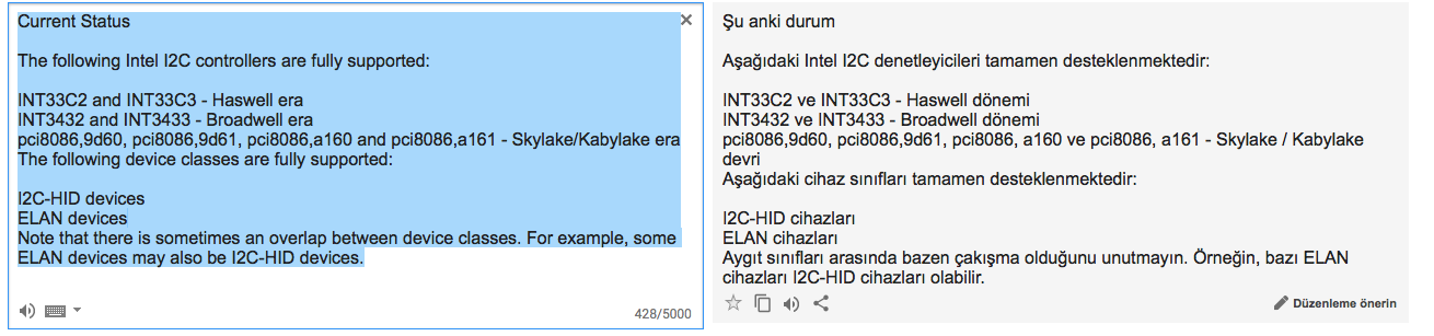

bu sınıflara uyuyormu bir bakarmısın lütfen
Compatibility
ben9923 edited this page on 8 Oct 2017 · 17 revisions
Pages 3
Clone this wiki locally
Clone in Desktop
Device ModelGenerationI2C Input Device ModelInterfaceSpecial Instructions
Dell Venue 11 ProHaswellSYNA7500i2c-hidMust be on latest BIOS. Windows 7 DSDT Patch required.
Acer C720 ChromebookHaswellCYAP0000
ELAN0000
ATML0000
Cypress/Elan Touchpad
Atmel Touch Screen
Must flash custom coreboot + Tianocore UEFI Firmware.
Acer C740 ChromebookBroadwellELAN0000Elan TouchpadMust flash custom coreboot + Tianocore UEFI Firmware.
Acer CB5-571/C910 ChromebookBroadwellELAN0000Elan TouchpadMust flash custom coreboot + Tianocore UEFI Firmware.
Toshiba Chromebook 2 [2015]BroadwellELAN0000Elan TouchpadMust flash custom coreboot + Tianocore UEFI Firmware.
Dell Chromebook 13 [2015]BroadwellSYNA0000Synaptics TouchpadMust flash custom coreboot + Tianocore UEFI Firmware.
ASUS X456URSkylakeELAN1000Elan TouchpadUse INT3442 & INT3443 DSDT patches
ASUS X556UASkylakeELAN1000Elan TouchpadUse Windows 10 + INT3443 DSDT patches and delete Lpss kexts
ASUS ZenBook UX305CASkylakeELAN1000Elan TouchpadN/A
Asus Zenbook UX305UASkylakeELAN0100Elan TouchpadINT3443 + Windows 10 DSDT patches
Asus ZenBook Pro UX501VWSkylakeELAN1000Elan TouchpadWindows 8/10 patch might be needed
ASUS Asus K401UBSkylakeELAN1000Elan TouchpadUse Windows 8/10 + INT3443 DSDT patches and delete Lpss kexts
ASUS GL552VWSkylakeELAN1000Elan TouchpadN/A
Lenovo Yoga 720 (15")Kaby LakeELAN0651Precision TouchpadWindows 10 DSDT patch
[TBODY] [/TBODY]
[TBODY] [/TBODY]
The following trackpads have basic multitouch: CYAP0000, ELAN0000, ELAN0100, ELAN0600, ELAN1000, SYNA0000, ELAN0651.

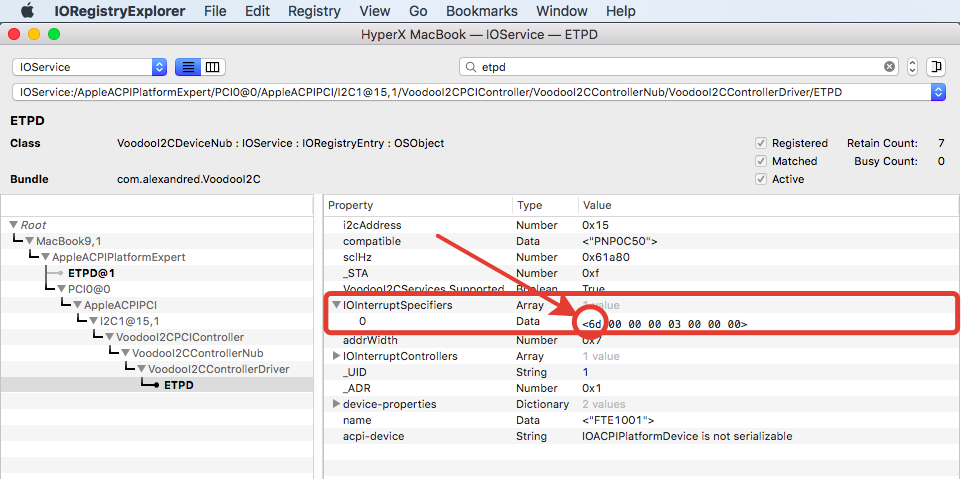

Report dosyam burada hocam, ben de patch içinde hata yaptığımı düşünüyorum şimdi onu inceliyordum.
Sanırım problem yaptığımız patchle alakalı hocam, baştan düzenledim cihaz kısmı yanlış olabilir diye. aynı problemi yaşayan başka arkadaşlar da gördüm forumda, cihaz id si 6D ile başlayanlarda olmuş, eski kext ile çözmüşler. olayın döndüğü scope bu ;

                        0x0055  // 6d nin karşılığı olan pin numarası 0x55 ancak düzenleyince 4 haneli atıyor.

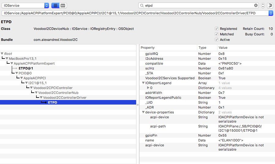

İş biraz daha detaylıymış hocam, çözdüm sonunda şuan hem dokunmatik ekranım hem de touchpadim mükemmel çalışıyor. Yakın zamanda rehber hazırlamayı düşünüyorum. GPIO kısmı özellikle biraz kafa karıştırıcı.

Mevcut DSDT dosyası üzerinden patch yaptığım zaman hata aldım, ben de sıfırdan başlamayı tercih ettim, controllers patch normalde skylake için geçerli imiş. kabylake için yaptığınızda da sorun yaşıyorsunuz. kullandığım 2 adet patch vardı ;
GPIO
Windows 10
Bundan sonraki adım GPIO düzenleme kısmıydı, sistemime uygun Hexdecimal numarayı bulup editleyerek sistemi yeniden başlattım.
