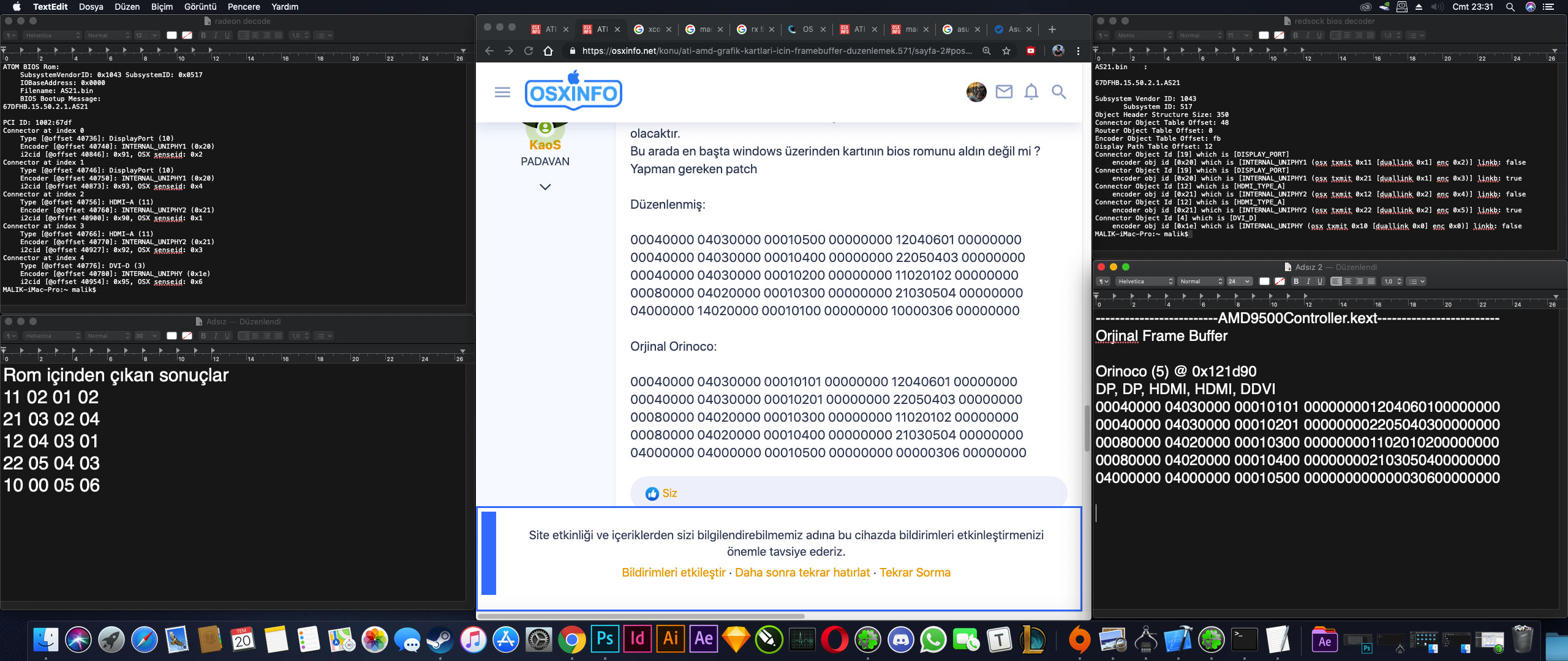

Rom içinden çıkan sonuçlar ekteki fotoğraf gibi ama biz bunu hangi sayılarla değiştireceğimizi bulamadık. Hane sayısı fazla konuda ki anlatıma göre. Yardımcı olursan çok sevinirim.
Radeon Bios Decode
ATOM BIOS Rom:
    SubsystemVendorID: 0x1043 SubsystemID: 0x0517
    IOBaseAddress: 0x0000
    Filename: AS21.bin
    BIOS Bootup Message:
67DFHB.15.50.2.1.AS21
PCI ID: 1002:67df
Connector at index 0
    Type [@offset 40736]: DisplayPort (10)
    Encoder [@offset 40740]: INTERNAL_UNIPHY1 (0x20)
    i2cid [@offset 40846]: 0x91, OSX senseid: 0x2
Connector at index 1
    Type [@offset 40746]: DisplayPort (10)
    Encoder [@offset 40750]: INTERNAL_UNIPHY1 (0x20)
    i2cid [@offset 40873]: 0x93, OSX senseid: 0x4
Connector at index 2
    Type [@offset 40756]: HDMI-A (11)
    Encoder [@offset 40760]: INTERNAL_UNIPHY2 (0x21)
    i2cid [@offset 40900]: 0x90, OSX senseid: 0x1
Connector at index 3
    Type [@offset 40766]: HDMI-A (11)
    Encoder [@offset 40770]: INTERNAL_UNIPHY2 (0x21)
    i2cid [@offset 40927]: 0x92, OSX senseid: 0x3
Connector at index 4
    Type [@offset 40776]: DVI-D (3)
    Encoder [@offset 40780]: INTERNAL_UNIPHY (0x1e)
    i2cid [@offset 40954]: 0x95, OSX senseid: 0x6
Redsock Bios Decoder
AS21.bin    :
Subsystem Vendor ID: 1043
       Subsystem ID: 517
Object Header Structure Size: 350
Connector Object Table Offset: 48
Router Object Table Offset: 0
Encoder Object Table Offset: fb
Display Path Table Offset: 12
Connector Object Id [19] which is [DISPLAY_PORT]
    encoder obj id [0x20] which is [INTERNAL_UNIPHY1 (osx txmit 0x11 [duallink 0x1] enc 0x2)] linkb: false
    encoder obj id [0x20] which is [INTERNAL_UNIPHY1 (osx txmit 0x21 [duallink 0x1] enc 0x3)] linkb: true
Connector Object Id [12] which is [HDMI_TYPE_A]
    encoder obj id [0x21] which is [INTERNAL_UNIPHY2 (osx txmit 0x12 [duallink 0x2] enc 0x4)] linkb: false
    encoder obj id [0x21] which is [INTERNAL_UNIPHY2 (osx txmit 0x22 [duallink 0x2] enc 0x5)] linkb: true
Connector Object Id [4] which is [DVI_D]
    encoder obj id [0x1e] which is [INTERNAL_UNIPHY (osx txmit 0x10 [duallink 0x0] enc 0x0)] linkb: false
Redsock ve Radeon Bios Decoderdan elde ettiğimiz sonuçlar.
11 02 01 02
21 03 02 04
12 04 03 01
22 05 04 03
10 00 05 06
Ekran kartın

Ekran kartın kaç mb ?
Bu config işini görecektir.
